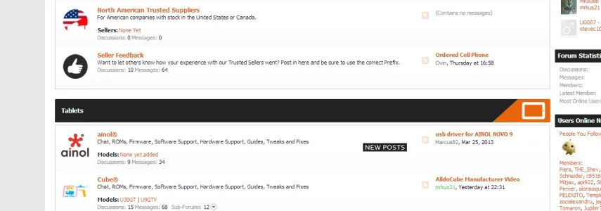

I use a different icon per node, however I don't use an alternative version to let users know if there is a new post or not, what I previously had was the following, however I can't remember what needed editing :(
From what I can see that looks like the node icons, I already have those. It's the 'NEW POSTS' bit that I'm trying to re-add, which only shows up if there are posts within the node which haven't been read yet.

It sort of works using the ".node. 'something'.unread {background:}" etc and I had it previously set up however I'm sure there's a simple way of doing it. After all it's basically setting one image for the 'unread' status and positioning it half way over the node, like the my screenshot. I find xF very well built and powerful, however the CSS classes do confuse me a little on there but I've worked most of it out.

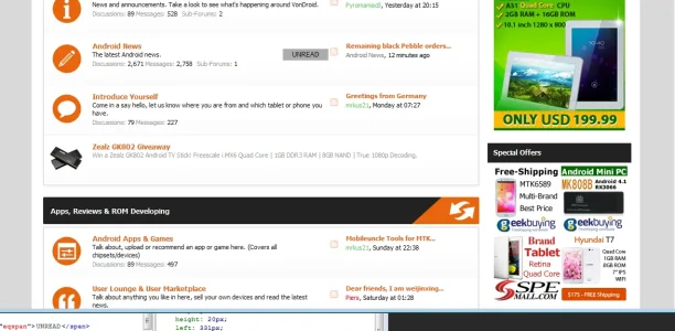

I did this live on your page with firebug real quick ...I didn't add an image because that is just secondary to the issue and I could just as easily removed the background color and used an image. We are looking for position first then beauty.
The real issue is a consistent placement regardless of the title length. If you do manage to accomplish this with css only you will run into problems in the long run.

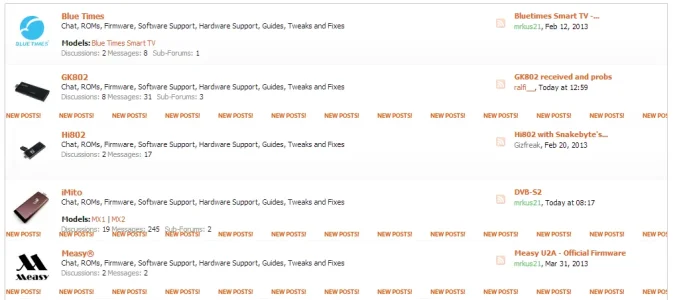

This is the code I was previously using... and it works to a point.
.forumNodeInfo.unread, .categoryForumNodeInfo.unread {
background-image: url(http://vondroid.com/site-img/unread.png) !important;
However background positioning doesn't appear to work so it repeats the image used. If I try and add positioning of any sort then it disappears without trace, I assume under another div, here's a screenshot:

background-repeat: no-repeat; would have stopped that repeating btw.
