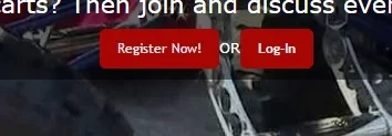

OUTL4W Active member Dec 13, 2016 #7 try Code: <a class="button" href="{xen:link 'register'}">Register Now!</a>OR<a class="button" href="{xen:link login}"><span style="font-weight:bold;">Log-In</span></a> this should show a button for either to register or to login Upvote 0 Downvote

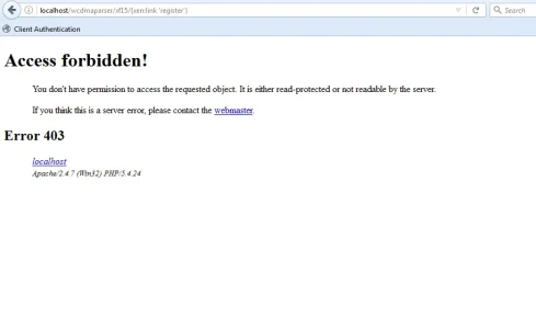

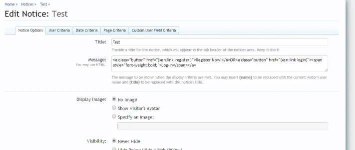

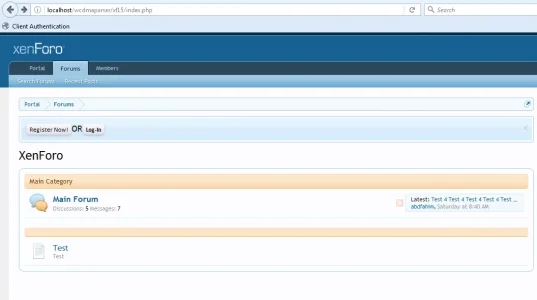

abdfahim Well-known member Dec 13, 2016 #8 OUTL4W said: try Code: <a class="button" href="{xen:link 'register'}">Register Now!</a>OR<a class="button" href="{xen:link login}"><span style="font-weight:bold;">Log-In</span></a> this should show a button for either to register or to login View attachment 145020 Click to expand... Doesn't work as above (pictures below). It works if I write as below, but I loose the login overlay functionality. Code: <a class="button" href="register/">Sign Up For Free</a><a class="button" href="login/">Log In</a> Upvote 0 Downvote

OUTL4W Active member Dec 13, 2016 #13 abdfahim said: Doesn't work as above (pictures below). It works if I write as below, but I loose the login overlay functionality. Code: <a class="button" href="register/">Sign Up For Free</a><a class="button" href="login/">Log In</a> View attachment 145024 View attachment 145026 View attachment 145025 Click to expand... Ahhh...guess I was a little confuzzled...I got xF notice confused with @Steve F version of stylized notice https://pixelexit.com/resources/welcome-notice-general-banner.18/ Upvote 0 Downvote
