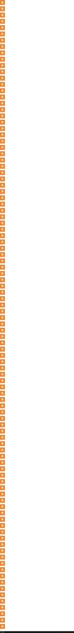

There's got to be more to this. I've just created this script:
PHP:
<?php
$dir = __DIR__;
require ($dir . '/src/XF.php');
XF::start($dir);
$app = XF::setupApp('XF\Pub\App');
for ($i = 1 ; $i <= 500; $i++)
   $addOnId = 'TestAddOn' . $i;
   $tempFile = \XF\Util\File::getTempFile();
   $path = \XF::getAddOnDirectory() . '/' . $addOnId . '/icon.png';
   \XF\Util\File::copyFile($path, $tempFile, false);
   clearstatcache(); // older PHP versions appear to cache the 0 byte size when the file was created
   $imageManager = \XF::app()->imageManager();
   $image = $imageManager->imageFromFile($tempFile);
   $uri = $image ? $image->getDataUri($tempFile) : null;
   if ($uri)
      echo '<img src="' . $uri . '" style="width: 64px" /><br /><br />';
\XF::dump(number_format(microtime(true) - $app['time.granular'], 4));
(Yes, I have 500 unique add-ons I had to write a script to create that many for this purpose)
And the diff dumped at the end is 2.1815 seconds.
Of course loading the add-on list could be different, but it isn't:
Queries 10 Time 2.4894s Memory 11.32MB
To be honest, I'd be happy with 2.5 seconds even at 100 add-ons. This is 5 times that.
Not sure if I'm missing something significant?
