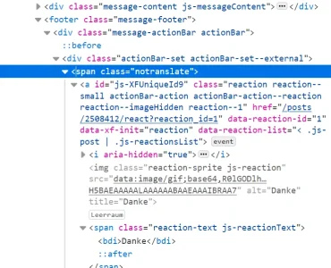

Hth... ;)

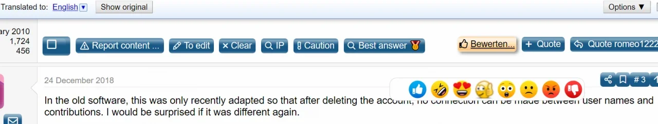

Ok, I did a couple of tests. Unfortunately, it doesn't work as expected.
You can (see screenshot my "like"=>"Bewerten" in german language.) prevent the "likes" from being translated,

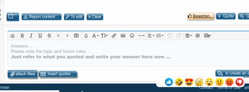

but you cannot prevent the extended likes from being moved to bottom, see the next screenshots.

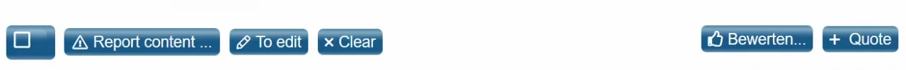

Codeview:
Userview:
The only solution I have found so far would be the posting that should be liked to scroll up to the Google bar, then the liking works, but only if the likebutton is not translated lol see screenshot
