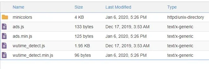

That is so bizarre. I run in development mode for testing and, well, development, without any issue. Hrmm. I'd almost have to see it to believe it. I'm not quite sure how to go about troubleshooting this when I can't reproduce the issue. Sounds like it could be something to do with your theme/javascript setup, and the fact that i removed the non "min.js" files from the /js/wutime_adblock/ folder.
Could you do me a favour, could you copy and paste the files in /js/wutime_adblock/ so that both *.min.js and *.js files exist.
Should look like:
/js/wutime_adblock/ads.min.js
/js/wutime_adblock/ads.js
/js/wutime_adblock/wutime_detect.min.js
/js/wutime_adblock/wutime_detect.js
Actually, in hindsight, I think they may also need to be in:
\src\addons\Wutime\AdBlock\_files\js\wutime_adblock\*
Should look like:
These appear to already exist there.
I don't have a "_files" folder.
Also I'm not running any theme on this site.
Oh right.
The non min.js files are left-overs from previous releases... can you delete them and copy and paste the min.js to rename them to the two you just deleted.
So to reiterate, delete the NON min.js files and copy the two min.js files so they exist as non-min.js
The problem in development mode is that Xenforo doesn't use the min.js files, it looks for non-min.js files (which don't actually exist anymore in the newest releases.....
Okay nevermind, this is getting way too confusing. Let me send you an update by private conversation to save confusion and your time :)

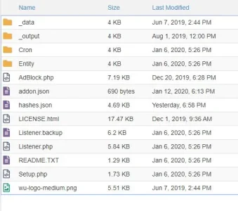

If you edited anything in the addon while in development mode, there is now a src/addons/Wutime/MYADDON/_output folder on your server. Delete that folder! It is a dangerous folder to have on a live site and could cause problems in the long run. Especially if it contains old data. It's basically used to override what is in the _data folder for addons.
Thanks for the insight. That appears to be exactly what was happening.
That _output sub-directory did exist in my add-on directory. I believe I edited a template associated with this add-on when in development mode a couple months back (I would assume August 1, 2019 since that was the _output sub-directory date). All was working fine with the add-on until I went back into development mode yesterday and that old modified template popped back up in the page code even though it no longer existed or was accessible in the admincp.
When I uninstalled the add-on and manually removed the add-on main directory and re-installed all was back to normal. I have a feeling if I would've just removed the _output sub-directory it would have worked to. Thanks again for the insight.
