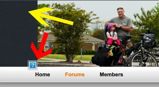

SDB33
This has been a HUGE help! Thank you!
What is the header color titled (see yellow arrow)? I have tried to change the color in the color palette and I can't find it. I have changed almost everyone....
Thank you!!

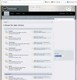

I tried this and I got the result I was after EXCEPT when viewed on mobile devices it looks terrible. The main logo is pushed down over the forum and the ad I put in does not shrink so overruns the screen. Anyway to fix this thanks.
Same thing for me. I think it needs a conditional perhaps that changes the style based on javascript users screen width. I'm not sure how to do it either though.
I've attached two screenshots, One is the desktop version looking good. Second is mobile overlap that xeanyngoat describes.

hang on a minute, isn't this a 'stock standard' feature of XF, ie the ability to put an image in an inbuilt add location on the forum without it messing up the responsive nature of the forum? This is not styling or custom work, in my opinion this is a core feature and it is not responsive.
