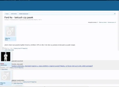

First picture is for the option without </li><li>

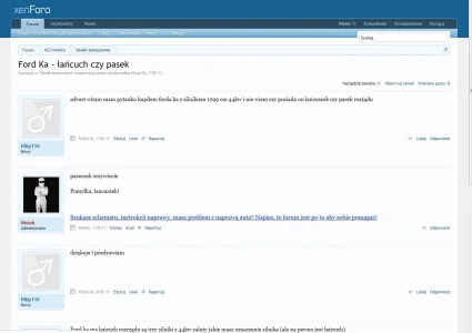

Second one is what happens after I use </li><li>
As you can see adding the code into ad_message_body is adding "advert" into first post. I do not want that. I want to have "advert" between first and second post.

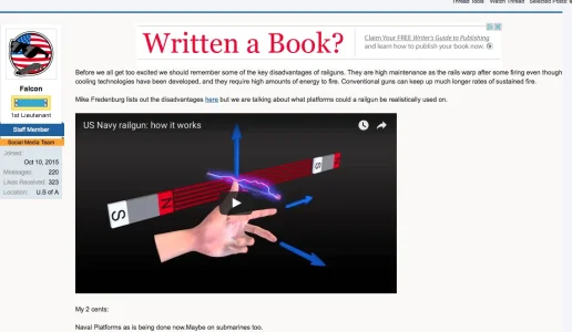

Bro it works with going under the first post, only problem is that it looks messed up for me. Any ideas on how this could be resolved or what the cause could be?
Thanks in advance.
I added the code to the ad_message_body to avoid the above issue but now I need the ad to appear underneath the content of the 1st post.
This is what I have now:

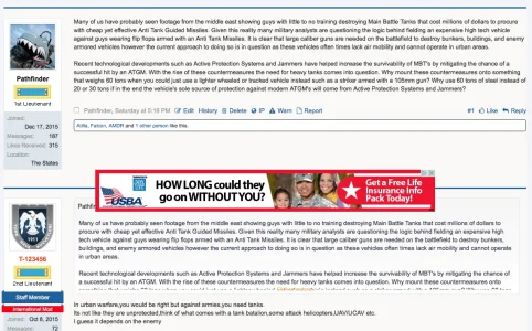

The reason why I need it under is because I have an ad in the ad_above_content template so it clutters the page as it is now.
