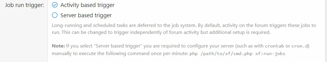

Hi,
How would this be done where it says on the image (This can be changed to trigger independently of forum activity but additional setup is required.)
I can't use the Server Based Trigger as my host won't go lower than 5mins on the cron jobs.
Server based trigger is what it is referring to. Additional setup is required to set up the server based cron. If you can’t use that then you’ll have to continue using the activity based trigger.

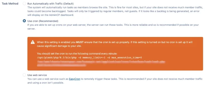

My point is... you get an instruction when you select server... give the SAME option/data for selecting an outside service. There are NO instructions on that in the ACP. You get TWO options. I spent a 2 day period back and forth with a new admin that was not technically savvy enough to understand what was was needed... IF that was an option in the ACP with instructions on how to implement it, he would not have had that issue.
Not EVERYBODY has years of Linux or server admin experience, and some simply can deal only with what a panel tells them to do.
At the least there could be additional information on how to utilize an outside CRON service to do such. With IPS (if I remember correctly) it pretty much gave instructions on how to do it also.
The example you later give proves the very point I was making.
My point is... you get an instruction when you select server... [..] Not EVERYBODY has years of Linux or server admin experience, and some simply can deal only with what a panel tells them to do.
Got it :) But this is MHO more of a documentation issue than a missing feature.
So modifying the option description phrase to include smth. like
The activity based trigger can be explicitly activated by making HTTP requests to https://domain.tld/jobs.php.
This can be useful if there is not enough activity on the site to trigger jobs on time and using the Server based trigger is not possible.
should be sufficient?
If you can run jobs via server cron this should still work, just setup a job to run
php cmd.php xf:run-jobs --wait --max-execution-time=250 every 5 minutes.

Yes, but exactly HOW many will actually read all that "little stuff". If one had an option, with similar basic instructions, it would be "easier" to find, as you and I both know, reading the small print is rarely done by some, they look for the little "block" to check that instructs them how. ;)
IPS does make it noticeable.
