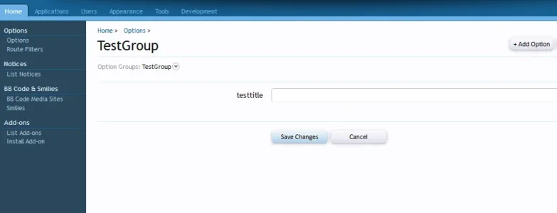

I meant this kind of option:upload_2013-11-4_16-56-27.webp
I also had two cron jobs from EWRUtils that I removed. I use xenforo since 1.0.3 and I did remove the files from some addons before clicking on "acp>uninstall" which caused sometimes problems, so I had to reupload files and click on acp>uninstall again to successfully deinstall the addons. It is very likely that all this caused some problems.
It's just that one option I used was filled with thousands of user_ids so it got quite huge with around 20kb and it was displayed to me on a random "check out the whole returnView template variable", and I was surprised it was there even after removing the addon. But I guess it happened because of the uncommon way of handling addons (see above). The option might be related to my specific addon ( I am not 100% sure and I deleted this option before looking at the addon_id row and I removed the other addon options from EWRUtils which were all related to EWRUtils).
The option was also there when I searched for the title or id of the addon. I have successfully removed the option on both my debug and live community so i can not provide you with a screenshot anymore. So I would prefer to have this but report closed.
