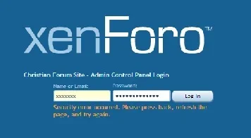

and when I login to the forum, it shows
Security error occurred. Please press back, refresh the page, and try again.
