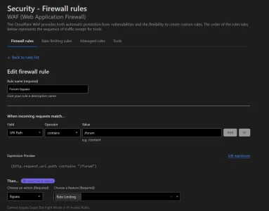

@Brogan I see you posted about a similar issue here:
So it seems cloudflare related, but you mentioned:
"You should be able to whitelist whichever rule is being triggered."

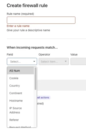

Any tips on how to go about that? What I see, various options:
