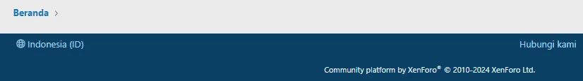

However, you could also set both variations as light or dark. In this case, the gadget in the footer will display the variation names instead, still allowing users to switch to a different color palette at whim.

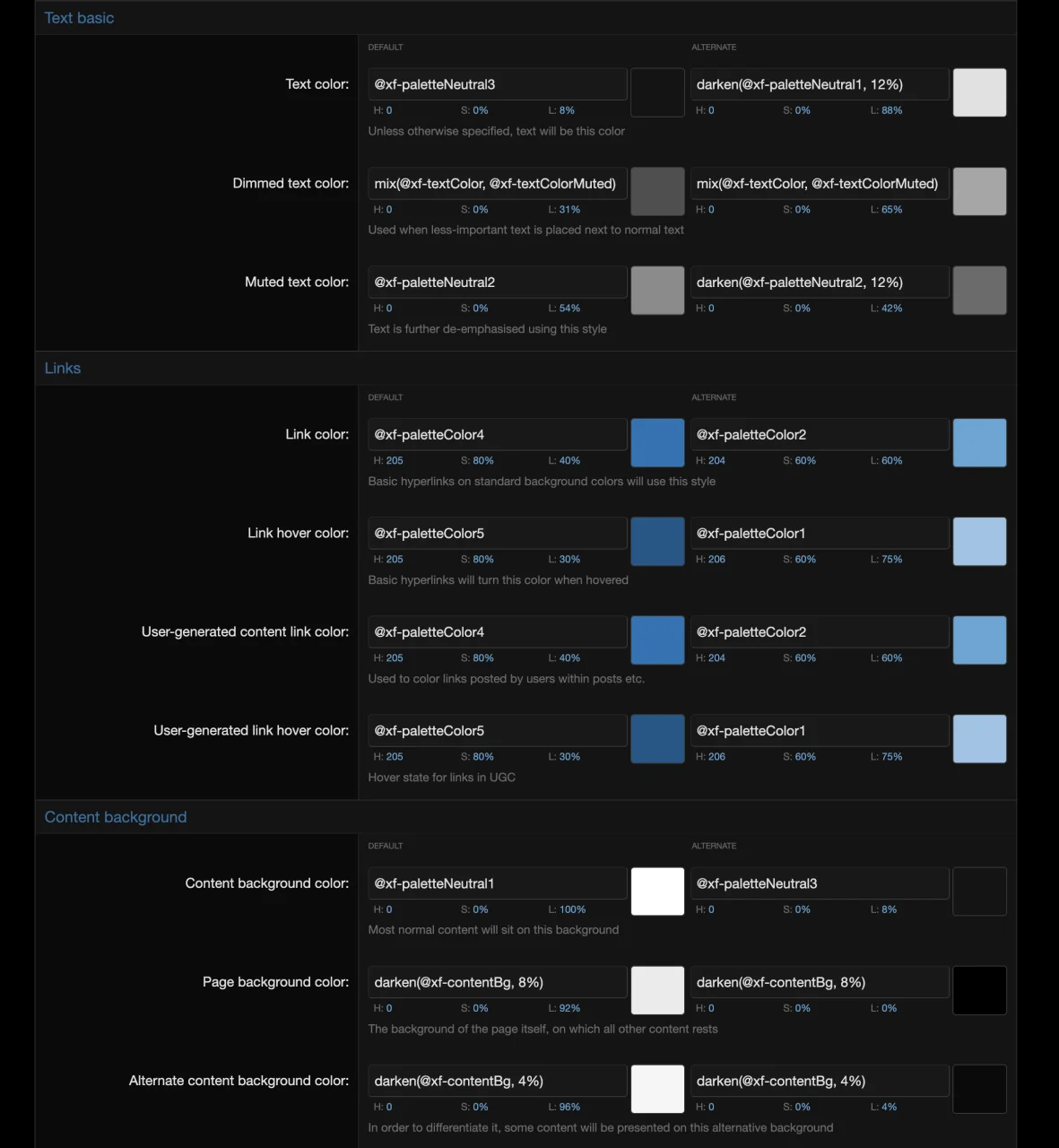

With variations enabled, the user is free to define completely different versions of the color for each variation.
Note that the ability to support variations is limited to color value type style properties and does not extend to CSS-type properties. Of course, that does not mean that CSS-type properties are unable to benefit from the variations system, because the color values they reference may themselves be variants. That is to say, if your header CSS uses
Additionally, in style properties where palette colors are referenced, variations are automatically inherited when using either the default or alternate fields, and can be manipulated using the standard color editing functions provided by XenForo, such as

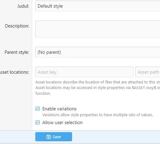

To enable variations, edit each of your styles in turn and toggle the 'Enable variations' option. Next, jump into the style properties editor for that style and concentrate on the Color palette and Basic colors groups.
In the default style, we took each of the Palette and Accent colors and reduced their saturation and lightness a little for the dark variation so that they are a little more muted against a dark background. We did not adjust the Neutral colors at all.
Next, in the Basic colors group, we switched around references to the Neutral 3 (dark) and Neutral 1 (light) colors, and in some cases reversed the references to palette colors, so references to Palette 1 now point to Palette 5 etc., making further adjustments with the built-in color functions as necessary.

From a style designer's perspective, style variations are handled as part of the style properties system. Style properties defined as a color value may be edited to enable variations, in which case they will accept values for each of the variations defined in the style.With variations enabled, the user is free to define completely different versions of the color for each variation.
@xf-chromeBg, which in turn references @xf-paletteColor5, then it will automatically pick up the variant value of @xf-paletteColor5 when defined.Future extension

In order to prevent any unexpected behavior when you upgrade to XenForo 2.3, we will not make changes to any of your styles. This includes marking your styles as supporting variations.To enable variations, edit each of your styles in turn and toggle the 'Enable variations' option. Next, jump into the style properties editor for that style and concentrate on the Color palette and Basic colors groups.
