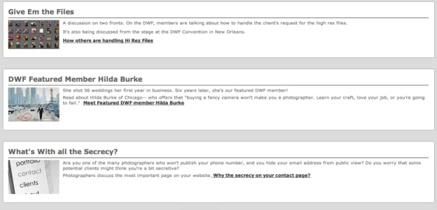

Hi,
I just bought the premium version of XenMedio and I was hoping that I could get some info.
I see that I can have recent and popular media show up in the tab when it's clicked, with the categories in the sidebar - but is there any way to have the categories in the main content area? I would like to have perhaps sections in the main area. For example, (photography stuff) Lighting Tutorials, Still Life, Portraiture, etc. The attached screen grab shows the sort of thing that I mean, but it would be with video thumbnails in the sections.
Can it be done?
Or can the menu tab take you straight into a category with maybe a list of the other categories there too (apart from the sidebar)
I hope that this all makes sense! Thanks! :)
Hugh
