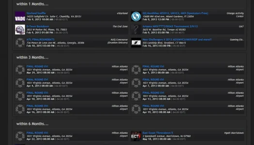

This is new... one of our members mentioned this bug in the system that has the event multiple times. :(
It looks like the event is marked to repeat every 1 week... thats not a bug. You and I both know FR16 doesn't repeat every week; just go into the event and fix it.
Also... are you gonna be at FR16? I dont know if I'm going this year...
Oh, in that case thanks... I'll edit the event then.
