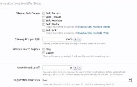

Oh crap! I didn't know there was that much spam on my site :O
I do not intend to use the sitemap as I'm currently using a different one. If I uncheck the settings(see below), will that disable the sitemap generator or is there something else I need to do to have it completely disabled?

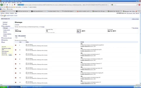

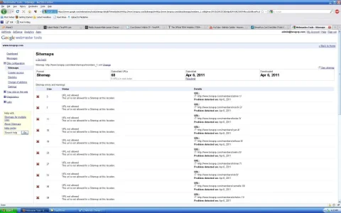

My google account shows my sitemaps are fine for my forums and wiki, but it is not working for my media nor members sections. It seems 100% of the URLs generate an error from Google "URL not allowed. This URL is not allowed for a Sitemap at this location." I just generated a new sitemap and the issue still exists.
The URLs are all valid. I tested them and they work. The permissions are set to where guests can view media and member cards. I tested and confirmed the links work for users not logged in. Sample links below:
http://www.terapvp.com/media/user-interface.16/
http://www.terapvp.com/members/admin.1/
My first question is, why is Google not allowing these URLs which are perfectly valid?
My second question is, I have appromately 50 videos uploaded but my media sitemap only generates 19 links. Why?
I read some articles from others who experienced the same issue. It seems at some point Google changed their practice and does not allow sitemaps from nested directories. My sitemap was currently at www.terapvp.com/data/sitemap which means it only allows URLs from www.terapvp.com/data. I moved my xml files to my root directory, resubmitted and it worked, no errors.
So now my question is, how can I change XenUtiles to automatically place the sitemaps at my forum root directory?
