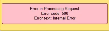

XF 1.3 500 server error
Lexy
When try install plugin gives methis error
Internal Server Error
The server encountered an internal error or misconfiguration and was unable to complete your request.
Please contact the server administrator to inform them of the time this error occurred, and the actions you performed just before this error.
More information about this error may be available in the server error log.
My host says to check permission folders, any suggestions??
also both recomended folders are set to 777, and i check all files for errors and its ok, server log nothing in there???One more thing files inside 777 folders got settings for 775/644??
When you change the chmod settings to 777 ensure you have the option selected to recursively apply that to all files and sub directories also. internal_directory and data and all their contents should be 777.
That being said, this is highly unlikely to be the cause.
The reason nothing is logged in the Server Error log is because this is happening at the web server before XenForo code is executing. Unfortunately your host has fobbed you off.
This is a 500 Internal Server Error. More details will be logged in the web server's logs. If you do not have access to these, then only your host can look at them and advise you what the errors are.
