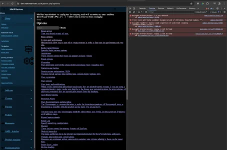

I know this is marked as resolved, but I've just attempted a 2.2.15 to 2.3.0 Beta 4, and end up in the same state as Pete's attempt:
It says it's resolved in Beta 5. I reran the install to complete the process. Have you tried that?

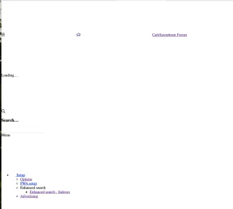

Yes, and rebuilt the master data. The upgrade completed, but the admin and front end are messed up as shown in the screen shot.
The issue with additional SQL I can get around, but the end result after that looks like Pete's
Set $config['enableListeners'] = false;
before rebuild Masterdata?

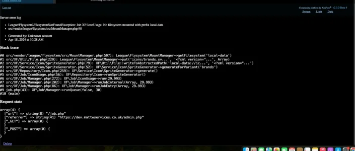

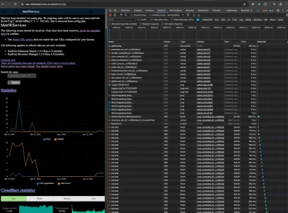

In the inspector, do any CSS files fail to load properly? Also it looks like server errors have been logged in case that's relevant.
No, there are no CSS files reporting missing or not loading.
Also, job.php is stuck in a constant loop
I wonder if the Cloudflare addon and R2 storage is causing issues?

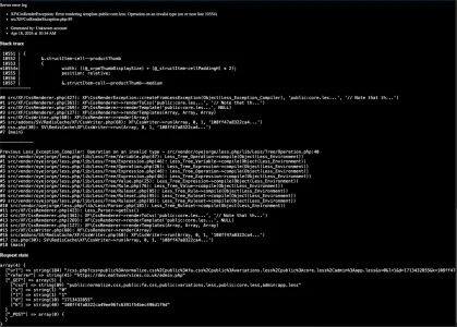

That appears to be from a template modification to core.less, there is no .structItem-cell--productThumb class in the core.
