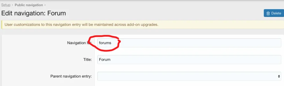

SOLVED
190590
My Navigation ID was set to forum when it needed to be forumS
From my experience every upgrade in the past I had to change the Title to forum after upgrades because XF upgrade overrides my forum title. So perhaps the last time around I not only changed the title back to forum but also the ID.
Fixed now. I know where to look for the same error in the future and maybe this helps others with the same error.
Thank you Mike for your prompt and grade-a support.
