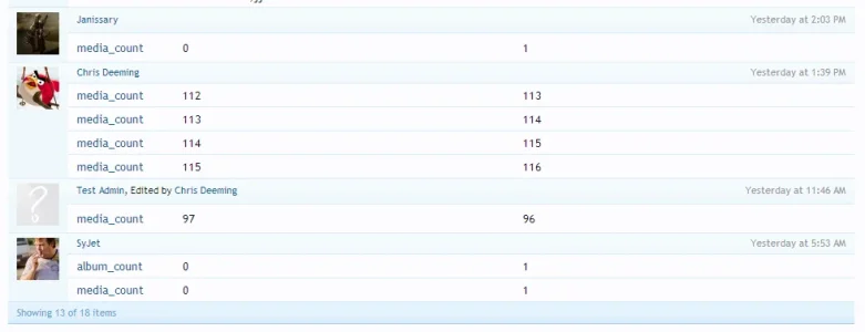

I haven't particularly taken a detailed look just yet, but is there a new way to prevent certain changes appearing in the User Change log? Is there any sort of flag we can set to prevent it from being logged?
I'm just not sure how useful this kind of scenario is for people to see in the user change log:
This is as a result of people just using my gallery add-on.
The counts are incremented using the User DataWriter so in that sense it is valid that they appear here, but perhaps it might be better if there was a way we could prevent that. (I may just change them to UPDATE queries if not).
See XenForo_DataWriter_User::$changeLogIgnoreFields. Alternatively you could update through a direct query which is how we generally do it (since it's much faster).
I think I will do the latter. At one point I was thinking of doing some stuff on pre/post save so I stuck to using the DW. Either way, $changeLogIgnoreFields is awesome and good to know. Thanks.
