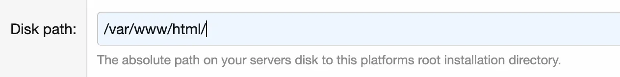

Edit:
I was just trying anything I could think of in XLink > Platforms, and changed the Disk Path from '/var/www/html' to '/var/www/html/' - notice the '/' at the end.
A few things happened:
  • The fatal error on all wp pages is gone and the pages are loading
  • The blog posts/pages are broken however, with css problems throughout, but all text and images on the page.
  • Categories aren't displaying the scrolling secondary nav bar
  • The featured grid isn't showing at all even though it's set up in options.
  • In XLink > Platform, the Disk Path text has now returned to '/var/www/html'
1. I had the exact same settings for a previous version of XPress, without the '/' at the end, and it worked perfectly, so how would anyone know you needed to add another '/' or why that even worked.
2. You should have something in the text for this field saying that '/' needs to be at the end. If this was there it could have saved me some hassle.
3. Because no further xlink_error logs have been created, I'm assuming the link is no longer the problem (with my pages being glitchy), but something to do with XPress? It seems like maybe something to do with thxpress_wrapper, the featured grid isn't rendering at all on the wp homepage, none of the categories are showing in the scrolling secondary nav bar any more either.
