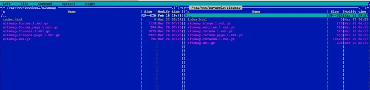

Mone says "cron entry was run successfully" but I never see info such as shown above (generating forums, generating index thread, etc.). Likewise, no entries in my server error log. Am I doing something wrong?
