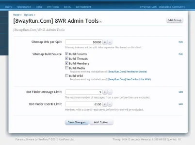

Digital Doctor... I've been building my own sitemap generator, taking some ideas from Rigel's work, and my sitemap generator will include sitemaps for my addons.
Cool. Are multiple sitemap generators a good idea (one for forums, one for addons) ? Doesn't make a difference ?

Digital Doctor... I've been building my own sitemap generator, taking some ideas from Rigel's work (but still completely written by me), and my sitemap generator will include sitemaps for my addons.
This is great! My Wiki has TONS of good info to search on google.
