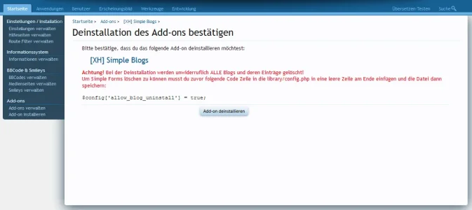

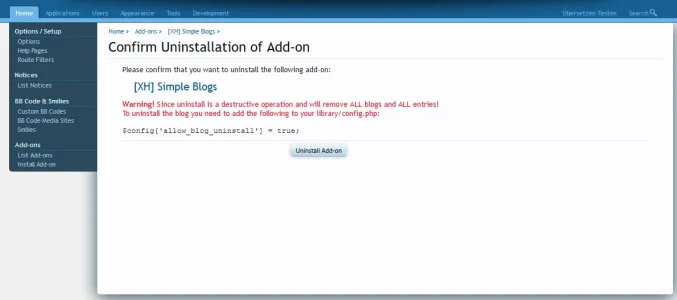

Next version will become a smarter deinstall screen, phrased - so its multilingual and one step bevor:

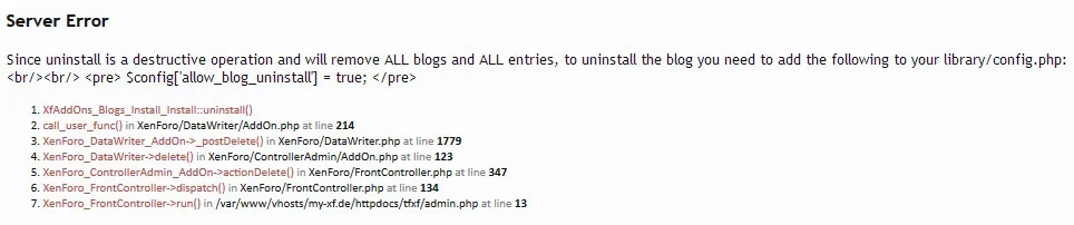

And the error message thats on screen in the actual version when you try to delete without the needed code in library/config.php:
its now for next release eleminated, its not needed any more. :)

But with exactly this as last line in your xenforo config file will work to propper deinstall the add-on.
It took me 3 tries this morning but finally got it to uninstall! :D

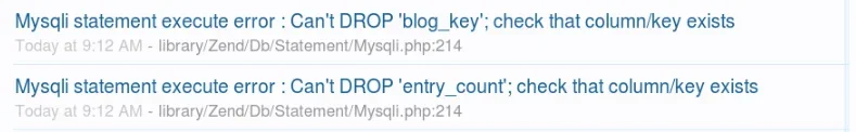

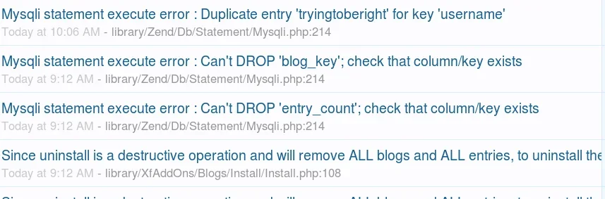

As I uninstalled the addon this morning, this happened:
Doesn't seem good. :( Does anyone know how I can fix this?
Thats why it is market as beta and why I say: make a backup bevor install... :whistle: ;)
But thats no big problem:
This:
is eliminated with next version, and more a notice. Ignore and delete it.
This:
says it cant delete whats not in table. Thats a problem from the original Better Blogs addon, and I solve this with next release. You can ignore it and delete these 2 error logs.
But this:
I see this notice the first time - please give me the complete error log entry to take a look at this. Sure this comes from Simple Blogs ?
After he gives me a look at the error log from the last error above - I dont think thats from the Simple Blogs addon (it comes up when the registration form is called).
