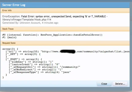

XeForo 1.2.2 just installed
add-on [Ice] Shop 1.0.2
Error
Zend_Db_Statement_Mysqli_Exception: Mysqli statement execute error : Duplicate column name 'cat_profit' - library/Zend/Db/Statement/Mysqli.php:214
#0 ###/###/public_html/test/library/Zend/Db/Statement.php(297): Zend_Db_Statement_Mysqli->_execute(Array)
#1 ###/###/public_html/test/library/Zend/Db/Adapter/Abstract.php(479): Zend_Db_Statement->execute(Array)
#2 ###/###/public_html/test/library/xfImage/Install.php(132): Zend_Db_Adapter_Abstract->query('ALTER TABLE `xf...')
#3 ###/###/public_html/test/library/xfImage/Install.php(50): xfImage_Install->_install_xfversion2()
#4 [internal function]: xfImage_Install::installImage(false, Array, Object(SimpleXMLElement))
#5 ###/###/public_html/test/library/XenForo/Model/AddOn.php(215): call_user_func(Array, false, Array, Object(SimpleXMLElement))
#6 ###/###/public_html/test/library/XenForo/Model/AddOn.php(169): XenForo_Model_AddOn->installAddOnXml(Object(SimpleXMLElement), false)
#7 ###/###/public_html/test/library/XenForo/ControllerAdmin/AddOn.php(187): XenForo_Model_AddOn->installAddOnXmlFromFile('/var/tmp/phpnKR...')
#8 ###/###/public_html/test/library/XenForo/FrontController.php(337): XenForo_ControllerAdmin_AddOn->actionInstall()
#9 ###/###/public_html/test/library/XenForo/FrontController.php(134): XenForo_FrontController->dispatch(Object(XenForo_RouteMatch))
#10 ###/###/public_html/test/admin.php(13): XenForo_FrontController->run()
#11 {main}

First, [Ice] Shop? Second, that was fixed already, not sure if your using the latest release or not.
