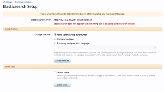

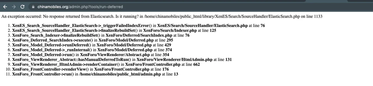

I see my elasticsearch wasn't activated on my server. Now I have activate it, but I make a mistake in the elasticsearch IP. But I don't see, where I can change it, after it's already enabled? :S
I become this messages o_O
