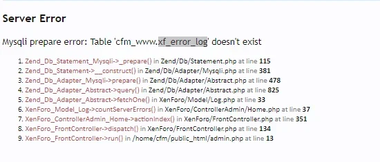

XF 1.5 xf_error_log Corrupted

Thanks.. yeah .. I have no idea what caused it.

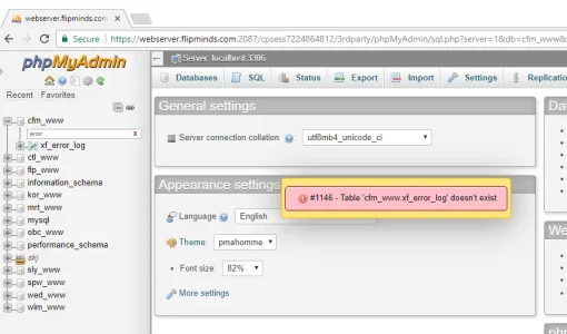

The tables was showing in the list of tables under mysql
But didn't exist.
I copied all the tables to a new temp database. Added the xf_error_log table.
I then deleted the original database and then created it again.
I then copied the temp database, back to original , and the problem has been fixed.
What caused the error? Maybe a server reboot while a backup was in progress. No idea. But this sorted me out.
