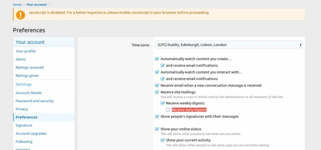

With JavaScript disabled, the input remains disabled:

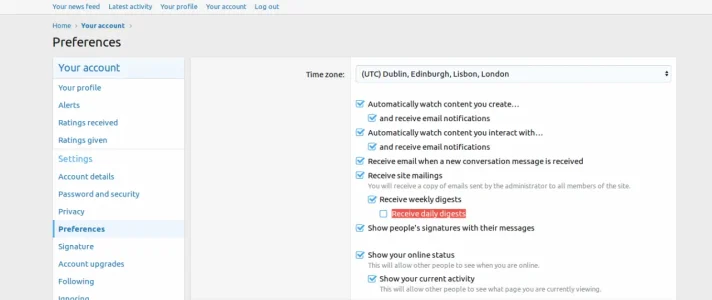

With JavaScipt enabled, the checkbox gets enabled and can be toggled:
