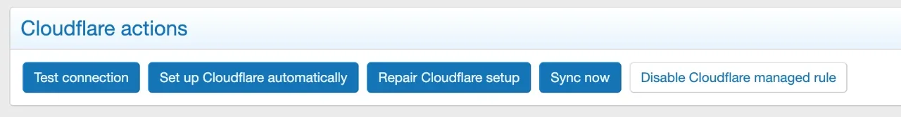

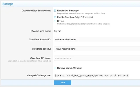

CF health check all okay with one warning:
Raw IP storage -> Enabled
