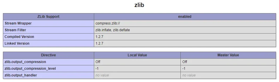

Can I ask, are you running this site with zlib also enabled as an extension?
Perhaps a new update for zlib is on the way to ruin many php8 XenForo sites.
zlib.output_compression is off here.

Just checked and zlib.output_compression turned off on our server.
