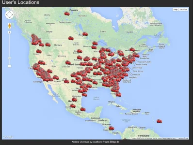

Xenforo User Map - User map generated on Google Map from user's profile location
This extension is for free, if you request it until christmas. To refund my time and investment, I'll take 15 Euros for each domain licence that's requested after christmas.
This extensions generates a user map with all your forum users who filled out their location field in their profile.

Awesome add-on :)(y)
But a more neutral name than mopedmap in the URL would have been nice :notworthy:
Not everybody is running a motorbike forum:barefoot: Anyway
I used little sail boats as icons :love:
