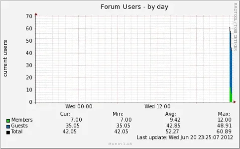

I'm trying to adapt the vbulletin munin plugin to track online members/guests to work with xenforo. See: https://github.com/munin-monitoring/contrib/blob/master/plugins/forum/vbulletin_users which isn't really a wise choice because I've not got a clue what I'm doing, but I suppose I'll never learn these things unless I start to try to do it myself.

Now looking at it I won't need to change much apart from the regex that's extracts the data which is currently:
/<strong>(\d+)\smembers[^\d]+(\d+)\sguests<\/strong>/im)
