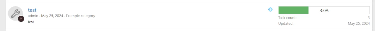

I purchased a product, but unfortunately, it does not show the percentage progress on the bar; it always stays at 0%. :( xenforo 2.2.15

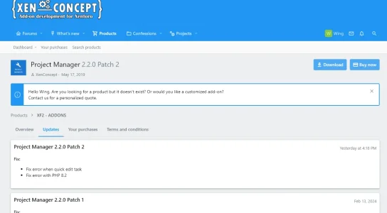

XenConcept updated [XenConcept] Project Manager with a new update entry:
New release 2.2.1
Update for XF 2.3
Note : This version require XF 2.3
Add :
  • Add attachments support for project comments and task comments
  • Now use the autopercent for progressbar completion
  • Add option in style properties for allow the project icon in search result
Fix :
  • Add a missing template xc_project_manager_inline_mod_project_move
