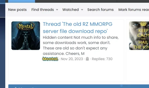

Any work around when using 2.3.3 and this plugin with the featured content option so that is nulls "hidden content" or any hidden features?

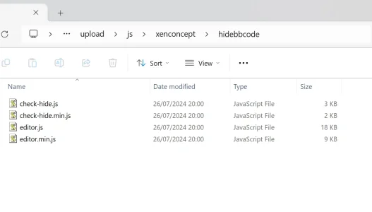

Upgraded to Xen 2.3.3 and this new version for 2.3 and I get the following error on console.
It appears to be missing from the archive. Having checked the archive;
FILENAME: template_modifications.xml
<replace>
<replace>
<![CDATA[ <xf:js src="xenconcept/hidebbcode/editor.js" addon="XenConcept/HideBbCode" min="1" /> <xf:js src="xenconcept/hidebbcode/insert-hide-button.js" addon="XenConcept/HideBbCode" min="1" /> $0 ]]>
</replace>
Hopefully this can be fixed.

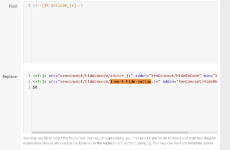

Fixed myself for now. For those wanting to resolve;
open file: addons/XenConcept/HideBBCode/hashes.json
  • replace the template_modifications.xml string with this
 "src/addons/XenConcept/HideBBCode/_data/template_modifications.xml": "89fa1dfe4d35a6158ae982feaec32395549a348aa956834d3ef5db1005057f15",
open file: addons/XenConcept/HideBBCode/_data/template_modifications.xml
  • find
<replace>
</replace>
replace with
<replace>
<![CDATA[ $0 <xf:js addon="XenConcept/HideBbCode" src="xenconcept/hidebbcode/message.js" min="1" /> ]]>
</replace>

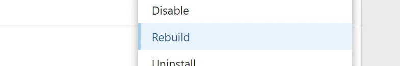

then go to admin.php?add-ons/ -> [XenConcept] Hide BBCode 2.1.0 and rebuild.

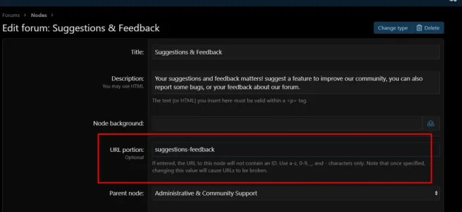

I just want also to share bug, If you edit URL portion of node, The hide BBCode icon will not show!
Any way to fix this?

  • Fix error with the node containing the url portion
