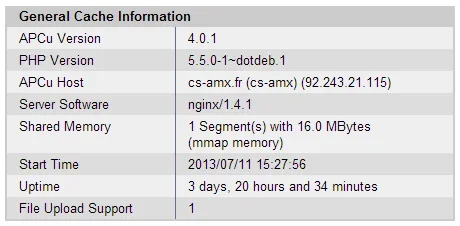

It's weird APCu Host is empty and Uptime is not running. What I have :
Well, no idea. It sounds like somehow loaded but not running. Try to check server log.
