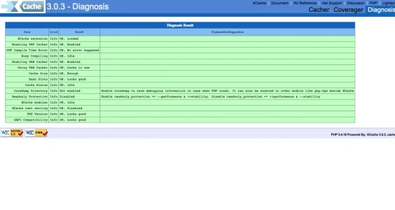

Hi,
Do you have any idea what that means?
I added XCache in my config.php, even in my vB config.php and that's weird.
It's telling you that there is nothing being added to the user cache. Are you using it to store sessions as well?
Yes, but I'm using a test area, so there are only 3-4 people who are using the system.
I think the session data should still remain, even after the people have stopped posting (providing they don't logout) - so perhaps the session data is not caching as expected?
I had a weird error that said I have no timezone in my php.ini
When I add a timezone , then I get the error above. If I delete the timezone, then I get PHP Compile time error (couple lines above in the diagnosis), but the VAR cacher error goes away.

I get logged out from the system at rendom times (while I'm translating). Is tihs connected to cacheSessions?
Probably. Is Apache restarting when you are getting logged out? Or, how are you running PHP (DSO/suPHP/FastCGI)?
