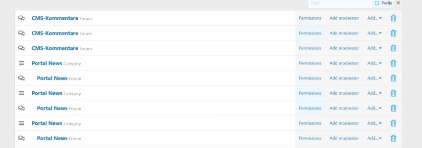

But another strange thing happened. Our node structure was tripled and that is the rease why "mark all thread read" suddenly is so slow. Suddenly we have for all categories, forums and sub-forums three identical nodes. Please have a look at the picture.
Next strange thing. Even though these nodes have correct permissions, the copied nodes do not show up in the forum list at the front page, only the original nodes show up. That is the reason, why i did not recognize it.
I already tried "rebuild forums", this did not change anything.
Any idea what happened here? Do you think it is save simply to delete the cloned nodes? Why don't they show up and where do they come from??? Hopefully somebody got an idea.

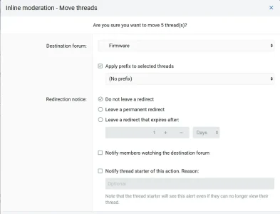

Mass move was done using inline moderation. I selected up to a couple of hundred threads. They were moved to another forum, in the same step they were assigned a prefix.

The problem is obviously caused by the plugin [8WR] XenPorta 2 (Portal) PRO. I disabled the plugin which caused all forums to be visible at the front page. I removed then the empty cloned forums and nodes in the admin UI. Now i have clean xf_node and xf_forum tables.
