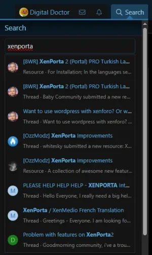

Here's is my XenPorta search

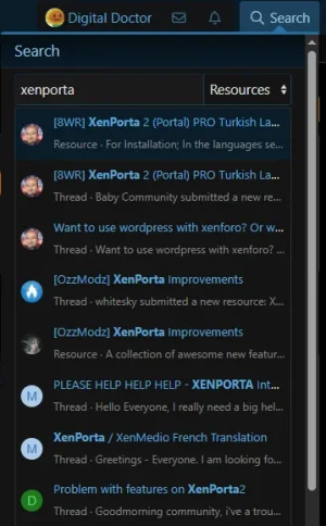

Xenporta search from the Resources Tab, manually restricting to just resources.
In the history of Xenforo searches, there is a 0.001% chance someone wanted the turkish translation first.
