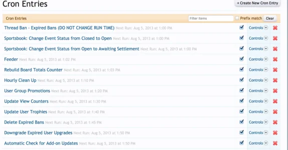

Look at the cron next run times. They're ordered by their next run time (earliest first). Are the dates/times in the past?
They're all up to date (I assume; it's based on your time zone). So are you sure you're having problems with cron? Or did I misunderstand what you were saying?
Well, this was a two ago now, not sure if it matters. The promotions didn't kick in and also the Sportsbook add-on didn't come through like it should have. I suppose they just didn't happen at the right time for the cron? I wasn't aware that everything like this ran on a schedule.
