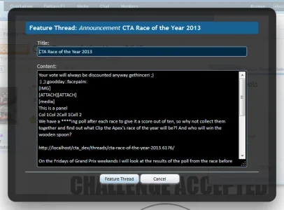

What that does is change this:

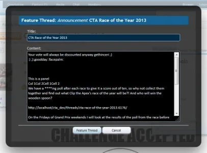

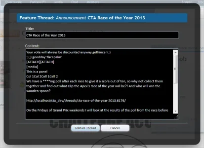

To this:
To this:

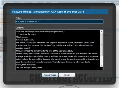

And finally to this:
