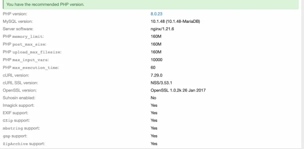

For ImageMagick... all you have to do is go to your dashboard page of the ACP and you can see immediately if you have support for ImageMagick.
