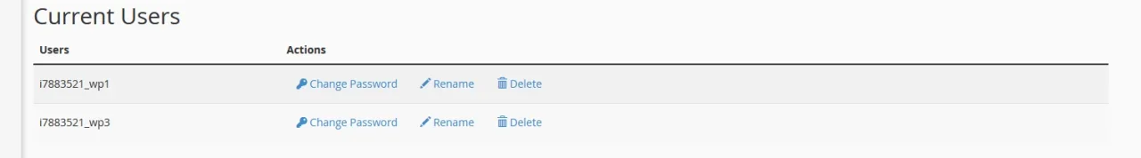

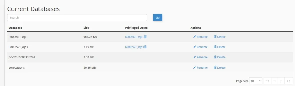

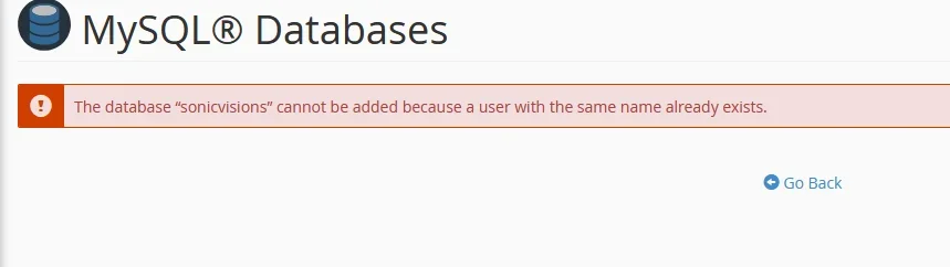

In my database control panel it only lists 2 users. The credentials of those users don't match my login. So I tried to create a new user that matches the credentials but then it says 'that user already exists'.
If that user already exists and you don't actually see the user between the users. Contact your hosting exactly whit this issue.
