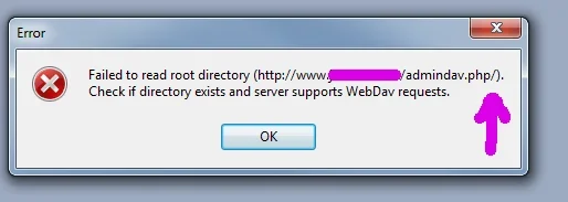

I'm trying to set up WebDAV on XF with NuSphere's PhpED.
Problem is, phped want a "directory" as webdav source, not a filename
( eg mysite.com/webdavstuff/ and it does not accept mysite.com/webdav.php )
Did anyone successfully set up PhpED with XF's webdav ? Am I stupid indeed ? :)
thanks for your help

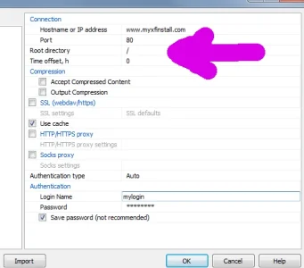

Even better, here's my exact PHP Ed Webdav set up:
It absolutely does not work over here :(

Is your XF install in Debug mode?
I seem to recall it working fine for me in PhpEd 8.
And it perfectly works in debug mode :)
Chris thank you, you spared me my licence renewal from PhpED :)
The error message from phped made me think this was a directory problem.
