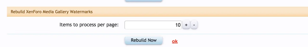

V vinafix Active member Dec 10, 2015 #1 I activated the Watermark and Rebuild but I do not see Watemark in all my media files Thanks you

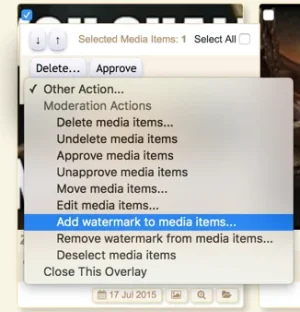

Chris D XenForo developer Staff member Dec 10, 2015 #2 The rebuild tool only re-applies watermarks to media which has already been watermarked; for example if you change the watermark image/size. To apply the watermark to existing images you would need to use the inline moderation tools. Upvote 0 Downvote

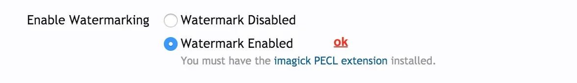

Chris D XenForo developer Staff member Dec 10, 2015 #4 If new images are not being watermarked either then there could be something else wrong. Can you screenshot the rest of your watermark settings? Upvote 0 Downvote
Chris D XenForo developer Staff member Dec 10, 2015 #6 I can't see anything obviously wrong with the settings. As well as installing the Imagick extension, does your server have the ImageMagick binaries installed? If you type "whereis convert" from your shell, does that return a path? Upvote 0 Downvote
V vinafix Active member Dec 10, 2015 #7 Well I installed ImageMagick. # whereis convert convert: /usr/bin/convert /usr/share/man/man1/convert.1.gz Upvote 0 Downvote

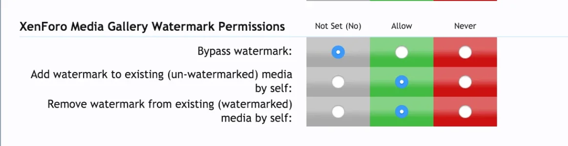

Chris D XenForo developer Staff member Dec 10, 2015 #8 When you're viewing a media item, do you have a button that allows you to add a watermark? Does clicking it add the watermark to that media item? If so then I suspect your account has the "Bypass watermark" permission set somewhere. (Check Admin CP > Users > User Permissions specifically). Upvote 0 Downvote
V vinafix Active member Dec 10, 2015 #9 Hnnnn Good Thanks you. It is true that my account with watermark Bypass Thanks you. How can I apply for all old files ? @Chris D Upvote 0 Downvote
Martok Well-known member Dec 10, 2015 #10 vinafix said: How can I apply for all old files ? Click to expand... Chris D said: To apply the watermark to existing images you would need to use the inline moderation tools. Click to expand... Upvote 0 Downvote
V vinafix Active member Dec 10, 2015 #11 use the inline moderation tools Click to expand... What is true I do not understand Upvote 0 Downvote
Martok Well-known member Dec 10, 2015 #12 vinafix said: What is true I do not understand Click to expand... This when you tick the top left of a media thumbnail: You can tick multiple items before adding the watermark to all of them in one go. Upvote 0 Downvote
