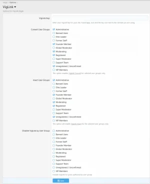

So the port_macro template modification is for those who want to disable VigLink for a certain user_group's posts. Say if you have a sponsor user_group and you don't want to affiliate your links, that's where you mark user groups in the disable option and that's when the post_macro comes in to play.

What option? All are set from default installation.

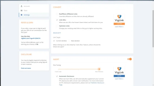

One more bug, selecting link will automatically open on edit post. Also why link are not open in new tab, not current tab?
This is done in the settings for your site at VigLink, http://publishers.viglink.com/publisher/settings/action/sites
