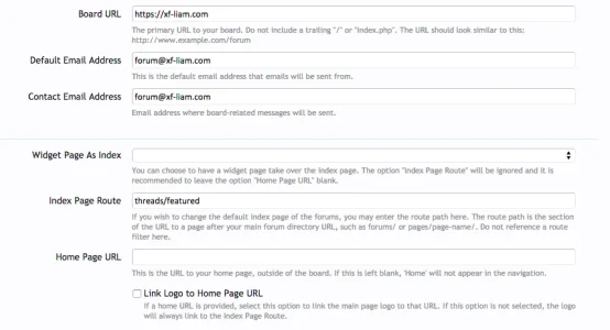

It's the root URL XenForo is installed at (IE where the index.php file is).
The index page route option configures what appears on that URL.
If you set the index page route to forums, then the forums will be the homepage.
For example, on XF Liam:
Which makes the featured threads portal the home page :)

The forums route is special - it's set to the home route by default, but if that is changed then the forums route starts working.
So, set board url to mysite.com
Set index page route to threads/featured
mysite.com/forums now points to forums
mysite.com points to CTA
This is exactly how I have it setup on XF Liam :)
