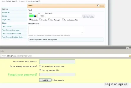

Neil E.
#5
I put the login_bar.css back to it's original code.

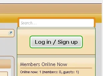

I went to Style Property Groups > Login Bar > Links and changed the color and font size and added an underline. Result below:
So the text color changed INSIDE the login box, but not at the lower right. The font changed in BOTH locations. I'm trying to only highlight the lower right link, preferrably with font size and background color. Continuing on, I tried to use Jake's code change with some additions.

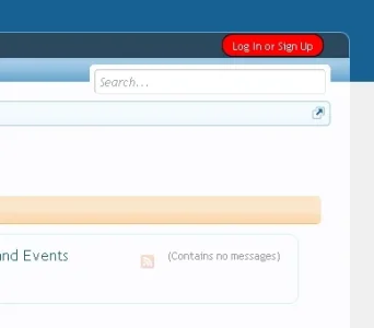

<xen:comment> CHANGE LOGIN LINK TOP RIGHT OF PAGE </xen:comment>
#loginBar a
color: #000000 !important;
background-color: #00ff7f !important;
border-radius: 5px !important;
padding-left: 10px !important;
padding-right: 10px !important;
font-size: 14pt !important;

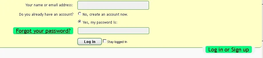

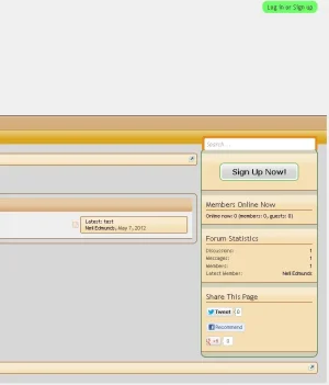

You can see some grey on both sides of the modified Log in or Sign up button. Increasing the padding further doesn't cover this (and also pushes the "forgot your password" link over two lines).
Note that I still want to only alter the lower right image (not both). Is it possible?
Steve F
#6
There is a style property under "Login Bar" called "Handle", that is what you change to make the background color you want. With your code above you are changing the background color of the links of the login bar.
The "a" is for the links only in that class
#loginBar #loginBarHandle is the class in the login_bar.css that controls the background. You should also be able to specify font size separately with that same style property.
Neil E.
#7
Ding, ding, ding ....... winner, thank you. I don't know how I missed the style property "handle" when looking for this.

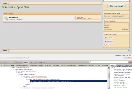

Quoted from this topic: http://xenforo.com/community/threads/style-properties.32483/
I use Chrome which has built-in dev tools very similar to Firebug. Load the page. Turn on the dev tools. Find the element in the HTML source and look at the relevant CSS associated with that element.
I'm not keen on Chrome, so I installed FireBug. Now our task is to identify where to change the Sign Up Now! text. Here's what FireBug shows when looking at that button:
How does this lead me to the css? I don't see the connection between the HTML source and the CSS. I want to understand how to do this stuff.

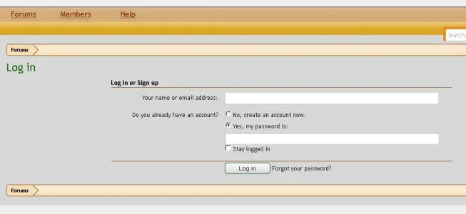

Unexpectedly this has defeated the "top of screen" push down login bar. Now when I click on my Log in / Sign up button (Sign Up Now! renamed), the page changes to a Login page. This is OK as I anticipate that most users will check stay logged in and not see the Login page anyway.

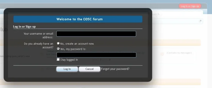

I finally decided not to use the sidebar at all. The only way to login is to use the login button that sits in the nav bar. This brings up Jake's neat login overlay. I have no problem with users going back to the forum index to login. They are already used to doing this.
