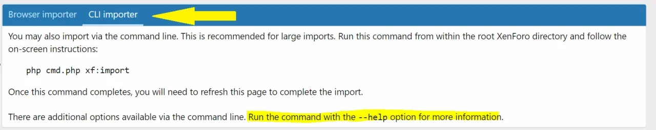

Before you start your import, there's a "CLI Importer" tab you can click for info.
