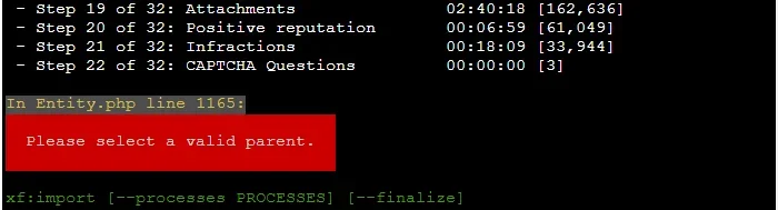

How did you get past this? I'm getting the same error:
Well, I'm not sure that we (@pipin is a colleague) did select CAPTCHA questions to be imported. But we had a similar problem at one or two other steps (one of them should have been the blog posts). I remember that I digged into the importer code and did set the parent id to the id of an existing forum node. I'm not 100% sure that this did help, because I might be mixing up both cases and I remember that we tried several times to finish the import before it finally did work. For the other case(?) @pipin did find a workaround here in the forum.
We have 16 million posts and our first attempt at an import took more than 24 hours to get to the point where we started getting this error. We got errors for CAPTHCA, FAQ and smilies. Frustrating is an understatement when it comes to importing a database as big as our is with so many errors in the import process.

Thank you for reporting this issue, it has now been resolved. We are aiming to include any changes that have been made in a future XFI release (1.4.0).
Change log:
Fix creation of container node for imported vBulletin blogs
