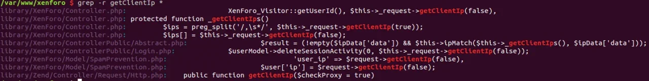

Now, browsing through the XenForo code, it seems there is some sort of support for X-Forwarded-For in Zend_Controller_Request_Http::getClientIp($checkProxy); the problem is this method is almost always called with the $checkProxy parameter false (see screenshot below). A simple "echo $request->getClientIp(false)" on the homepage indeed returns 127.0.0.1 so this won't work.
