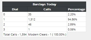

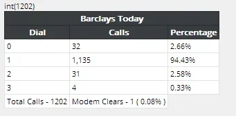

This is what it's outputting the results like
If I replace the $total in the $clear_percent variable with a static figure, I get a calculated %, but when I use the $total variable, it's not working.
Any idea why this wouldn't be available (when I can actually echo the value of $total out)?
